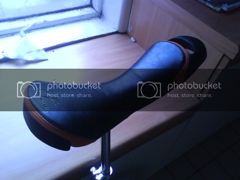

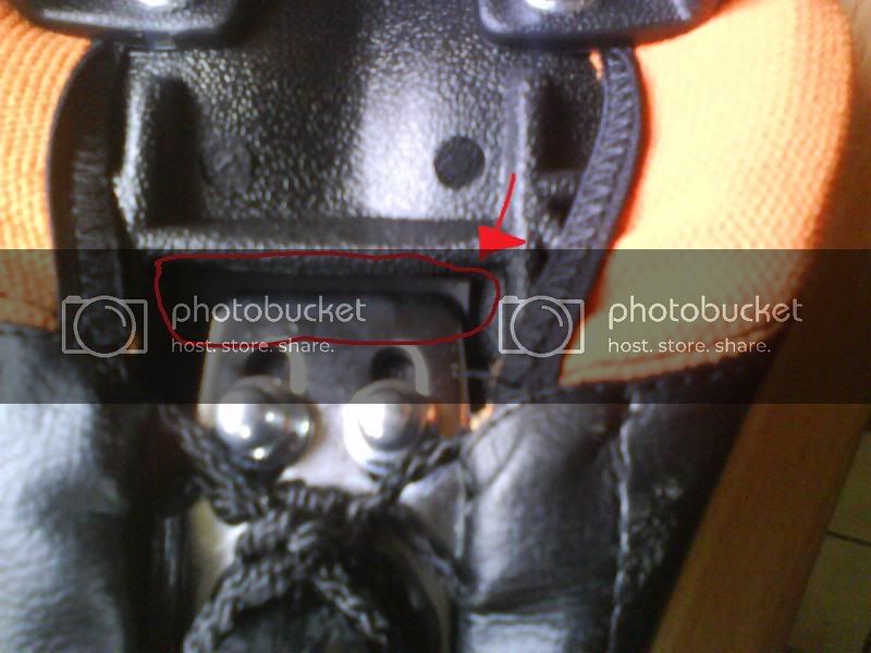

I got my new seat last night (due to me snapping the original). Even though it’s plastic, I looked at putting a piece of rubber between the seatpost and seat to try to avoid any ‘cutting in’ from the sharp edges of the seatpost. Then found that the bolts weren’t long enough for me to be able to put the rubber in. They must design them so that the bolts are just long enough for the seatpost bracket.
So instead, I filed down the edges of the seatpost (only 1mm or so, just enough to stop there being any sharp edges) and I also managed to wedge little piece of rubber in at the back (where I presume all of the presure will be).
New seat:
Underside of seat:
Has anybody else tried to reinforce their seat in this way at all? I’m not sure whether it might put extra presure on the seat or whether it will help.
The issue with plastic bases isn’t that the seatpost cuts into the base - its that the metal stiffener plate inside isn’t strong enough and snaps. Without that support the plastic then breaks. It should be interesting to see if that helps any but I don’t believe it will do much at all.
yea its not that it cuts in…it just cnt take that much weight and snaps. I had a double stiffener plate (welded together) and mine still snapped.
