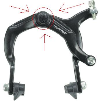

the easiest brake to put on your cycle is a caliper brake.
all you have to do is drill a hole through you crown to bolt the brake to (make sure this hole is very very straight). then you need some kind of post to come out of you seat post to mount the brake level on. you can use a bar end.
this is a caliper brake, the circled part is where it gets attached to the frame
