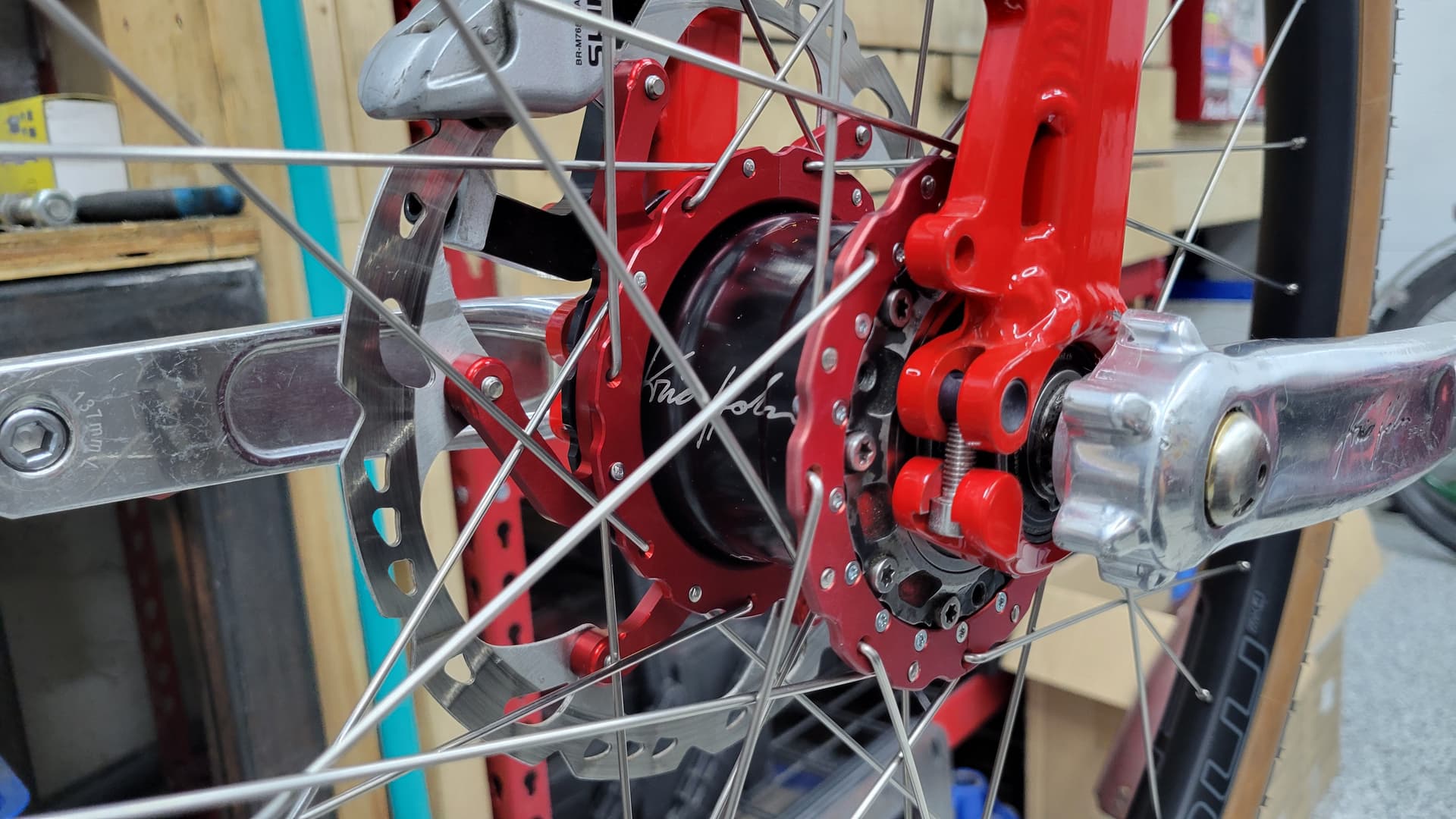

Coming back to the BrakeFast adaptor! Depending on your brake caliper, your brake adaptor, your frame and maybe your hub series, you may have to file more or less the rotor screws, the brake adaptor and the brake caliper (this last one is the scariest!). Even with a lot of filing, you may not be able to put your brake as you’d like it to be, because the rotor screws may hit the caliper. It has been bothering me for nearly 2 years now. And I may have found a solution!
Do you know the extremely short-headed screws (link in French, the English website seems to work badly)?
Those heads are extremely flat so they don’t hit the caliper nor the adaptor! That’s a massive helper if you don’t want to mess up with your brake!
The bad point is that they are expensive: 0.87€/screw. But that’s just 6 screws so I guess it’s OK to avoid filing a 100+€ caliper :wink:
Notes: you’ll want M5x10 screws. Those should not be countersunk, unless you want to machine the BrakeFast and/or the rotor.
I used these on mine that I used when testing the Brakefast, but only as they were just what I had lying around at the time. I did chamfer the disc slightly as well to help them seat and get lower profile again.

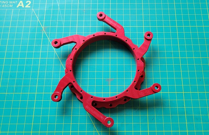

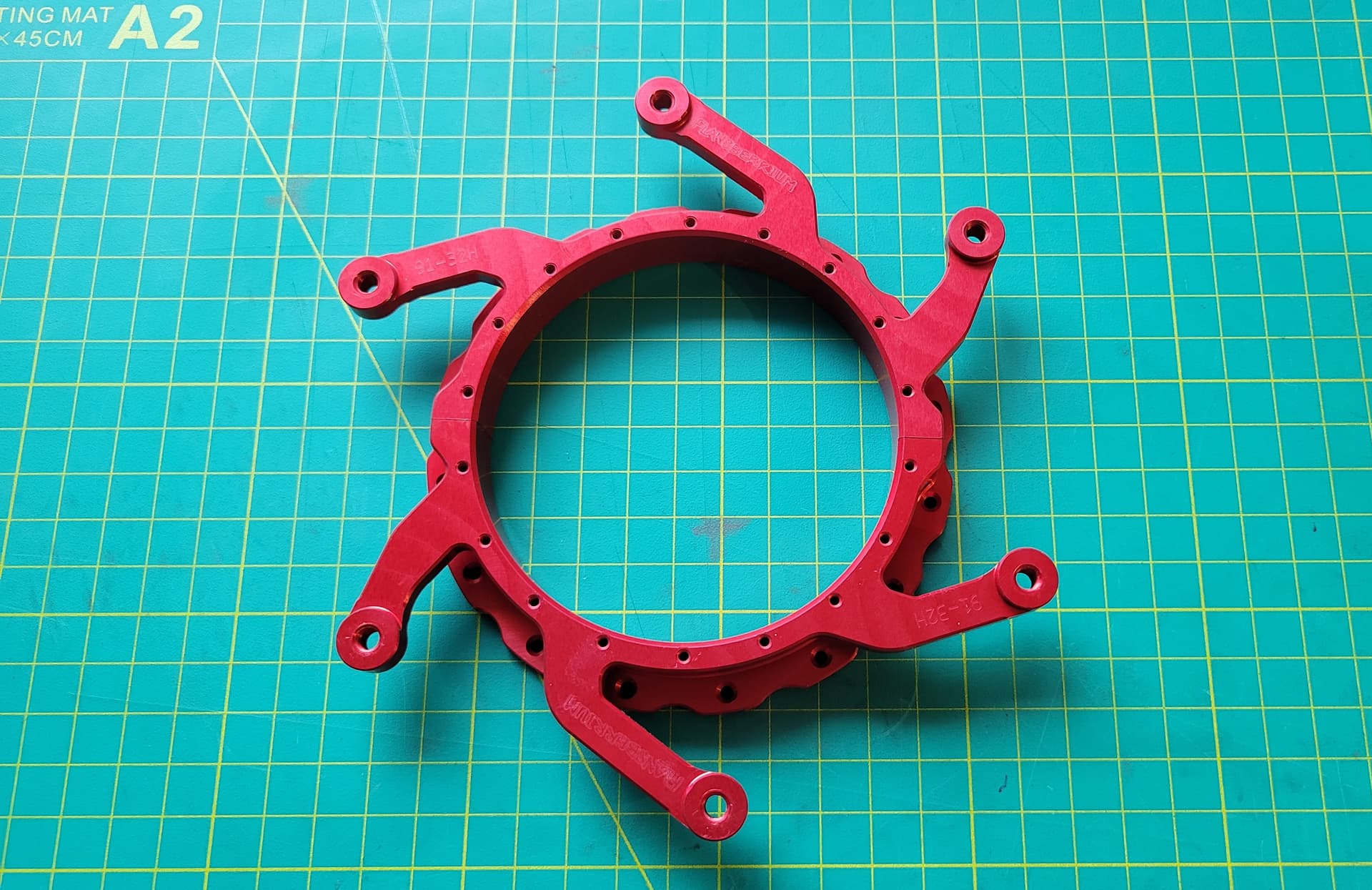

I’ve taken apart my G26 - the first wheel that set me off on this path, and using its hub #M274 it has been a delight to set this up with the powder coated 32h adapter with the most likely plan to build this into a copy-cat P Frame set up using a 700c rim and narrow ish gravel tyre.
That decision still awaits. But I have this part ready for whenever my rim of choice is clicked and arrives.
Such a great process following the video (thanks Roger!) and the quality of this item is second to none.

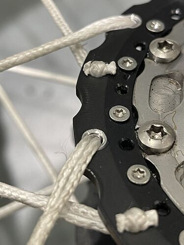

Anyone here have any views on doing the hub prep needed for Berd Spokes to the BrakeFast adapter itself?
There’s something seriously terrifying about taking their drill bit to your expensive hubs to ream material away, but once you’ve done a couple you begin to realize it’s a fairly straightforward and low risk operation.
This quote here from this page: Review: Berd PolyLight Fiber Spokes | The Loam Wolf
It’s kind of reassuring. Both that others are concerned and that it isn’t that bad when you get started.
I still see the BF flanges having a decent amount of metal on them and they seem fairly smooth already, so I would hope it would be a slight removal of metal operation.

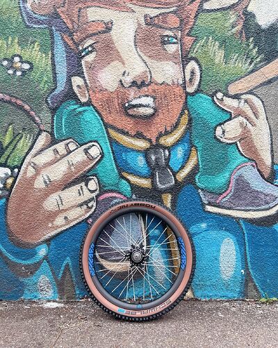

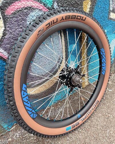

It’s happening - soon to be completed G26 using BrakeFast 32h - Berd spokes
Amazing! Did you have to drill into the BrakeFast? I’m eager to have your feedback on such a build :heart_eyes:
Yes Ryan did have to file the adapters surface but it is very minimal:
I feel oddly confident that this will end up making the BrakeFast adapter safe (last longer).
Plus he was able to spoke this in such a way that the two half flanges have been pulled together across the join:
Annoying the tyre logos are in my OCD view upside down, but I can solve that.
Now the totally aesthetic focused question do I dye the spokes blue or blue and yellow??
That’s a great thing you can do when your BF has 32h. That’s impossible to do with 36 holes, though :frowning:
Now that I have seen the finished build in the other thread, I vote for all blue.
