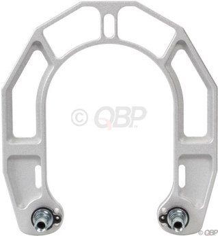

Would there be anything wrong with simply drilling holes in my frame and bolting the brackets on. Sounds so much easier then the braze option, but I figure there must be a reason.
Complete wrong idea, D-Brake is so convenient !

I already have the brake though.
Yes. Your frame would break. Probably. Would certainly seriously weaken it, and not something to do unless you like injuring yourself. There’s a reason brake mounts are brazed on.
Not the brake. D-Brake is a bolt-on mount for the brake.

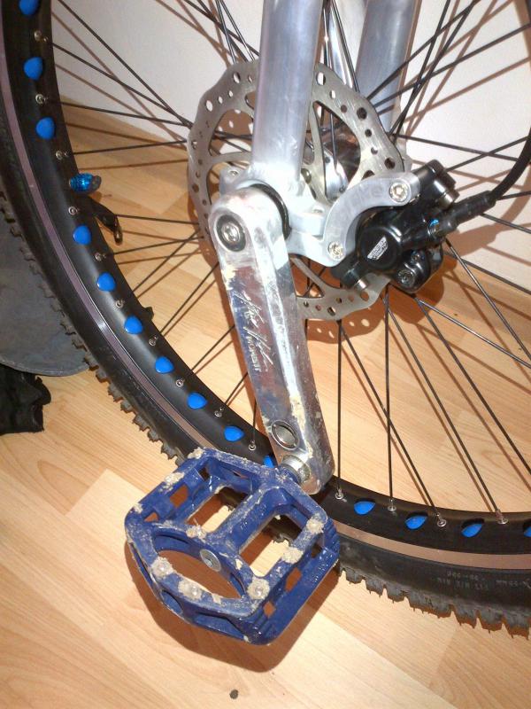

If you want to use V’s you could scavenge a brake bridge complete with brake studs from an old suspension fork, and strap it on with hose clamps. I had a setup that was made to put v’s on a frame without brazing and it was pretty much the same thing. Unfortunately, the one I have isn’t made any more, but here’s a photo:
