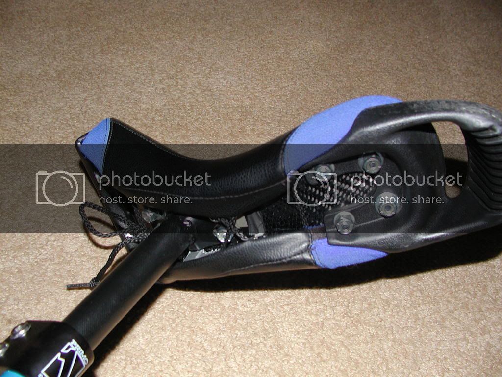

here we go!!! i got the cf base in, wish me luck!!!
Take some pictures of the process or the final results if you can. There aren’t many pictures showing how the bolts and CV base all fit together.
Don’t worry about being perfect. None of the holes in my CF base are square. Some holes ended up being filed to a rectangle shape (like a slot) to move the hole over because the hole drifted while being drilled. There is plenty of room for slop. The hole just needs to keep the carriage bolt from spinning and for that it only needs two points of good contact (like in a slot). Perfect square holes are not necessary.

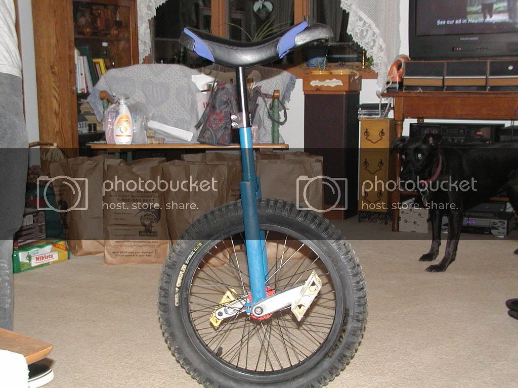

there it is, its very nice
here are a few more…
the whole uni
