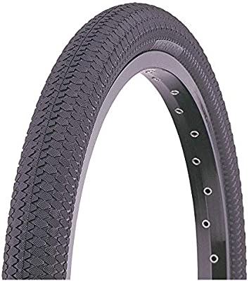

I don’t know the specifics of why a 2.5 tire is preferred over a 2.25 for street riding but while I still had my 24 I really enjoyed this tire:
