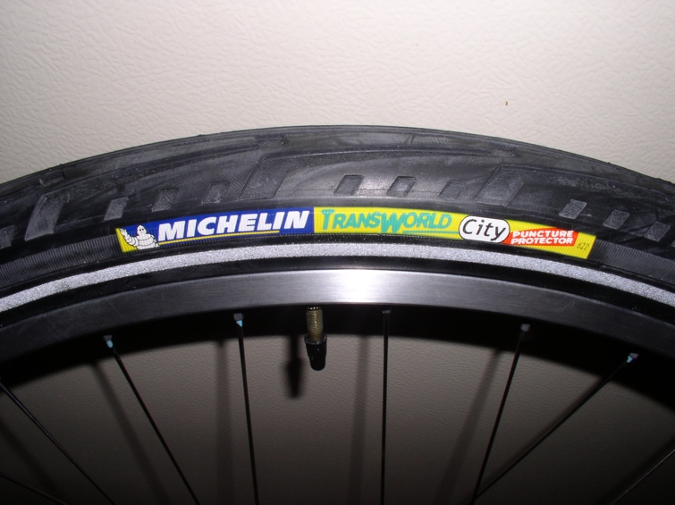

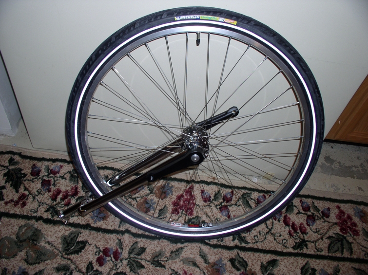

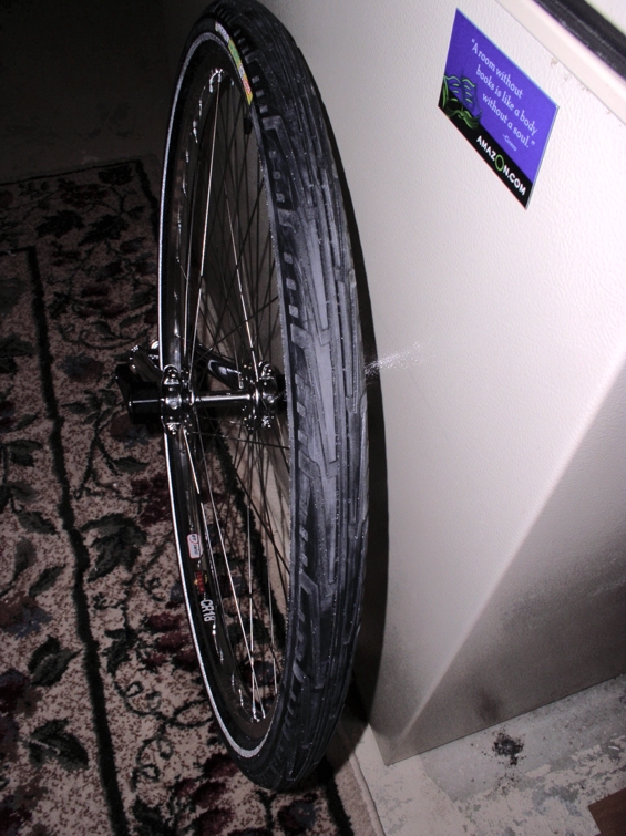

OK this tire should do you, Eric. The vertical fit has about 5mm of space in your frame. It’s the Michelin Transworld City 700c/47c. Here are three pics. The tire is listed in the QBP catalog and can be ordered through your LBS. It has a roadish water-shedding tread. The rim shown is a Sun CR18, which is narrower than yours, as far as I can tell.
Another pic
and another. Good luck!
