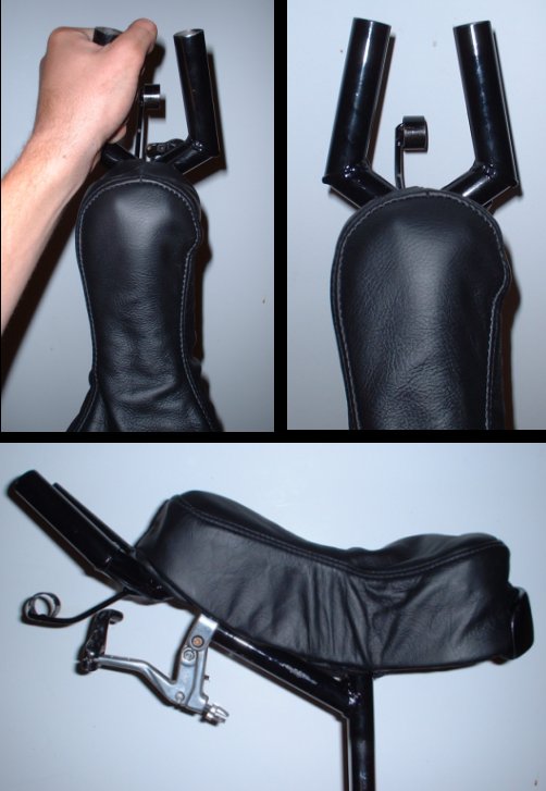

Yes, here are a couple of pics I just took. I may be leaning forward too much causing my legs to be too close to the handle.??
I may have to post twice til I learn how to put multiple file attachments.

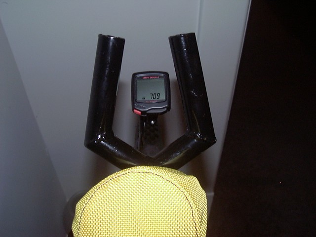

Here’s a pic from the top.

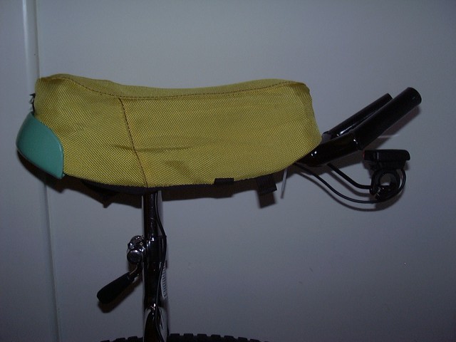

I notice that the black covered seat is angled up more than the roach covered seat. this may have a large effect on whether or not the handle rubs on your legs…
i second that.

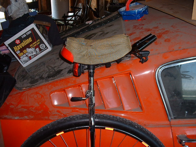

Here’s the side view of mine. It’s a stock Miyata base on a stock seat post. Joe

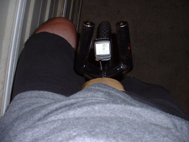

And here’s a pic I took while sitting on it with one leg fully extended. It may be hard to tell, but my legs don’t touch the handle. Since I’ve had the Coker, I’ve raised the seat quite a bit. You may find that raising the seat will help. cheers…Joe
I’ll try raising the seat. That won’t help mounts, as it is I can jump up and freemount regularly, except when I’m exhausted. I’ll also try sitting more toward the rear of the seat if I can. Thanks for the tips, I’ll let you know.
trsrdr -
I found that my air seat was a lot more comfortable when I raised the front up a bit. I eventually made a seat post that held it at this angle. You can get the same result by placing a few washers between the seat base and the seat post.
