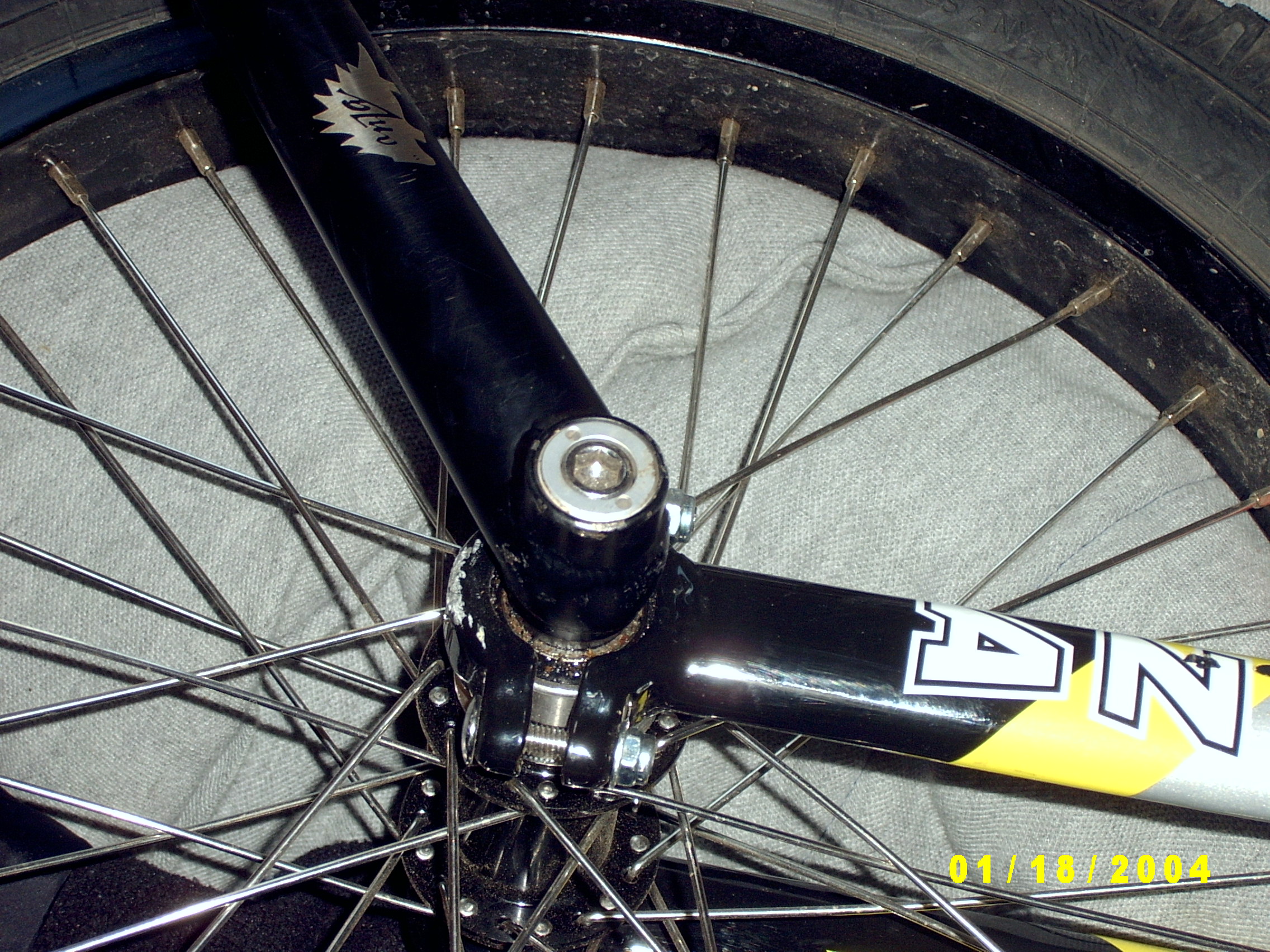

i was riding and looked down and…gasp! here is the crank with the missing piece. its not the side i crank grab with so i dont know how i lost it. i think its just a dust cap but if not…darn.
sorry the pics are so big but here is the side with the piece.
That’s more than a dust cap, it’s the self extractor for the crank. With that thing in, unscrewing the bolt in the centre will pull the crank off. Without it it’ll just remove the bolt but leave the crank there.

if i have a crank extracter tool then i should still be good right? just unscrew bolt, then use crank extractor as i normally would with a square tapered crank…

Nope. I have the old onza, and I lost the dust cap on my non-crankgrabbing crank, too. The dust caps are reverse threaded, so a normal crank-extractor will strip out your cranks. Also, the tool for removing the dust caps is called a spanner wrench. I don’t have one, so I use a hemostat (aka roach-clip for you stoners out there), or small scissors.
A note for all you onza owners: I have the old Onza, and when I took apart the cranksert, I found the bolts were tightening on the splines. I put a washer in there to rectify the problem. I reccomend you do too. It only makes the bolt stick out an extra 1/8". Also, the hub works like the profiles. Don’t fully tighten the right crank, alternate. 1/2 turn right, 1/2 turn left… That way the axle stays centered in the hub. If you do one side completely first, you can pull the axle out of the hub (I’m not saying this from observation, but sadly, experience).

so how do i take the cranks off?
You could try using an Evercraft bearing puller as in this thread.

Well then, how about a pin spanner?
Park Tool makes one.
Park Pin Spanner SPA-2

That’s easy. Just leave the dustcap on and unscrew the bolt. The dustcap is reverse threaded, so when you unscrew the bolt, it pulls the crank off with it. Then, remove the only dustcap, put it on the other crank, and repeat. Check the tightness of the dustcap after putting the cranks back on. Also, leave the dustcap on your pedalgrabbing side, so that if you land hard on the crank, it’ll have less of a chance of ovalizing tha ring on the outside.
Unicycle.uk.com sells spare Onza hub bolts that come with the extraction washers I think they’re £9 though…
