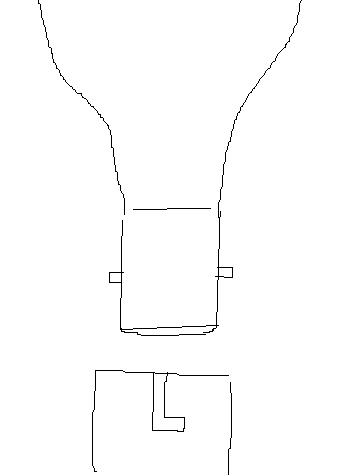

Sorry to change the topic, but wow you must have strange lightbulbs over there. What’s this ‘twist off’ business?

Andrew:
I’ll show you mine if you show me yours!
It has two little bits that fit into grooves. You push it in (it’s spring loaded or something) and then twist it.
Andrew
