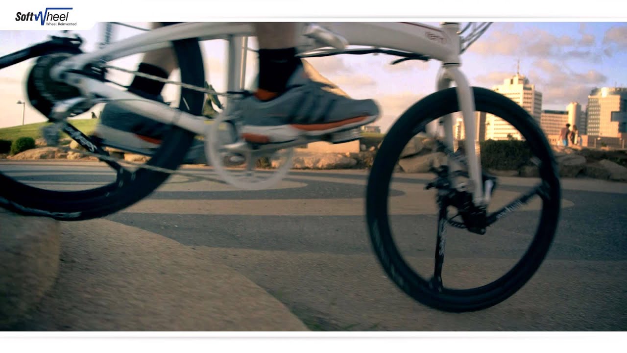

No one has said this so I will.
This film is a very nice production indeed. But the terrain is what I would comfortably do without getting out of the seat on my roadbike. He even rides on smooth gravel towards the beach but edits out before getting anywhere near the sand.
Whereâs the video of some downhill on a rock garden?
I donât think this is a wheel for off road. So how useful is this suspension? ![]()
