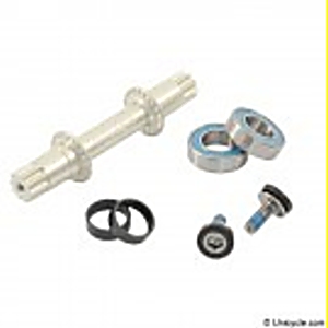

Yeah, the bolts take the same 8mm allen key size, but the thread diameter is smaller than the standard 8mm ISIS bolt, or so I was told, so the smaller hole makes the axle thicker at the splines. The bolts sure look like a smaller thread diameter. In fact, they look a lot like these.
Yes there is a big difference! I saw a few of these before and the holes are TINY!! My only biggest concern would be stripping out the hub threads. Be sure to put grease on everything, Ive had some bolts be a complete pain in the ass to take off when there wasnt enough grease. The tolerances are small on the hubs so everything fits very SNUG.

I’m sure using a smaller bolt, and hence having a smaller hole through the middle of the axle does make them stronger - the trouble is that adding extra metal to the centre of an axle is a very poor way of adding strength, so the difference isn’t going to be huge.
