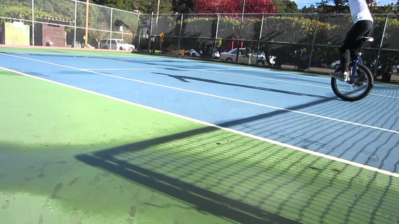

For now my progress has been: rebuilt my 20" brakeless freewheel into a 24" with maggies. I can coast a few meters standing up on the pedals on flat ground. With hills and actual riding I cannot coast at all. I was unable to use the brake very well while practicing on tennis courts, but I took my unicycle to commute a bit.
Uphill: I was fine, except that I really suck at mounting uphill. I try to get my first foot to pull the pedal back, but I still always and up with my cranks up and down; then I jump and smack forward/down the 2nd pedal to get going. I either get it by luck, or my foot slips, or I stall. On flat ground, I don’t have to jump as hard or smack as hard and am also more likely to be able to ride out of a stall.
Downhill: I can pedal-brake-pedal-brake. I fall off when I don’t brake hard enough and lose too much speed before my center of mass is forward enough for me to pedal. Basically, I can pedal and bring the wheel in front, and also brake to bring the wheel behind me, but I cannot control either very well and oscillate quite wildly. I definitely cannot find the balance point yet, brake-coast-brake is out of the question right now.
Great video! And great progress! I like the seat drops at the end. The only thing you need now is a larger place to practice with maybe some gentle descents.
