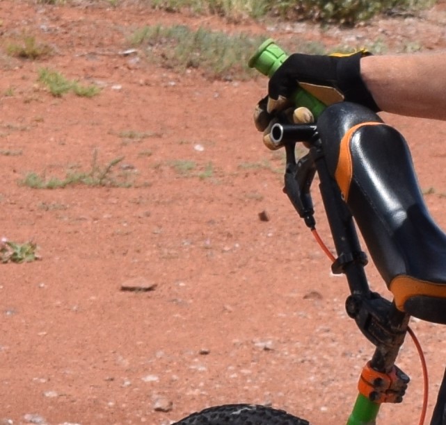

I have decided for my liking the normal grab handle positions your hand in an awkward way.
A similar idea to bar ends on a MTB I feel like having my hand turned 90 degrees gives me much more control over the uni. I can pull up on the handle quite easy or rest my weight on it. I only ride muni and have decided to just go with a right handle. If i want to ride with both hands it works great to hold the saddle handle with my left hand. Also as a bonus breaking is very easy(no star fighter required) :slight_smile:
