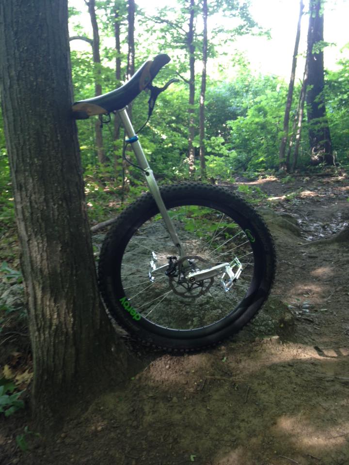

I got to ride a few trail miles on Medaceina’s 27.5+ uni, described in this thread, and I really liked it. With the bigger tire, wheel size is similar to my 29" with a 2.4 tire, but it felt faster, more nimble, and better cushioned.
Mine rides like a monster. But it is.
I have a 2.35 Schwalbe Hans Dampf tire for now. Derby Carbon rim. The whole thing weighs under 5kg. I find 29" too big for my area (really rocky and hilly). 26" is good for DH, but I can have that little extra speed on the 27.5". Plus it’s setup with a tubeless tire, and that means I can hit whatever I want, however I want at any speeds.
But there’s 1.5kg difference between my 26 and my 27.5".
I love it! :smiley:
Or you could just go whole hog and get a 27.5 set up with a Hodag…
I crunched the numbers and have a hard time reaching the sub-5kg mark except if you are running without brakes.
OTOH, I don’t remember seeing the detailed specs of your 27.5" muni (except for the rim & tire)… :wink:
I never posted on the forum! And I have only 3 pictures on facebook. So there it is… and it has a brake :wink:
The seat-seatpost is what saves the most. I couldn’t get a lighter setup (unless I put Ti bolts under my seat and I remove my foam).
Specs:
Scott Wallis Carbon fiber seat base
KH Street foam and cover
Thomson 27.2mm seatpost
Salsa Lip Lock clamp (with Ti bolt!)
Custom Flansberrium frame (with Ti hardware!)
Custom Flansberrium 32h hub (Crmo)
Double butted Sapim spokes (silver)
Derby 27,5" All Mountain rim, 32h
Schwalbe Hans Dampf 27,5 x 2.35, Trailstar, Tubeless
KH Spirit cranks 110-137mm
Avid Elixir 5 brake (with Ti hardware!)
Avid 180mm rotor with aluminum spider (And Ti bolts!)
DMR Vault pedals
That brought a little tear to my eye. It’s a thing a beauty. And people were saying carbon rims wouldn’t work. : P
I bet that thing has ups too! Looks like it would be really fun on the whoops.
Thanks for the build details Jacob :slight_smile:
Really looks like a nice build and it confirms that carbon on a muni is possible… :smiley:
(I don’t know if it is the pic but the frame legs looks sooooooo thin…).
Carbon
So why would anyone think carbon rims would not work on a unicycle?
Not only it’s possible to build, it lasts and rides super well.
I’m pretty sure it’s the picture, it does look really thin there :stuck_out_tongue:
I can’t find where I wrote it’s total weight, but I wrote somewhere 4,5kg without pedals.
Carbon wasn’t was good as it is today a few years back. I’ve always been a bit suspisious about riding a carbon rim too. But working in a bikeshop helps doing those things, not only I get better prices (still crazy expensive), I also get to see parts in action before I buy them. Carbon wheels have gotten bigger and bigger in the mtb world and are just doing good things so far. I haven’t taken mine down big drops, but I smashed it on rocks a few times (I ripped my tire at 2 places).
It does make the uni much stiffer though, my first ride wasn’t confortable at all. I got used to it!
EDIT: I just noticed this post kinda belongs to the carbon rim thread… Let’s stay on 650b subject… :stuck_out_tongue:
