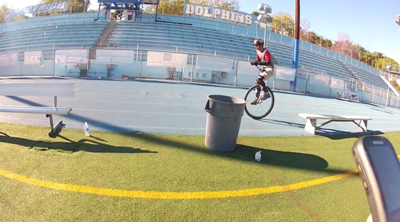

MuniAddict, where is your picture from? What track is that? A high school track or college track?
It’s Pacific Palisades High. My fastest lap on my ungeared 36er is :58. I do feel like I hold back from going totally all out, but it’s mainly due my fear of falling at speeds faster than I can run, lol! Part of it is also the time it takes to mount and get up to speed. I’m also wondering if I could go faster with my t-handle removed. I could also get up to speed faster with 125’s vs the 114’s I was using, but overall I think the 114’s are better. The area I felt the most resistance was in the turns, where I could really feel the tire “digging in”.
