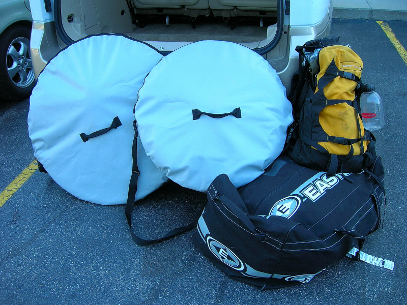

Yes, to above mscalisi thoughts. In addition get some soft foam and include that on both sides of the wheel as well. It won’t add weight, just more protection. When I rode New England a few years ago, I traveled with both the 29er, thank god, those mtn climbs are steep, and my 36er. I put jerseys, socks, etc, soft goods in with the wheels and carried frames, pedals, etc, hard goods in the hockey bag. Attached is a picture of all of my luggage for 2weeks of riding in New England, including two unicycles. The soft bags worked just fine, with the additional protection.
