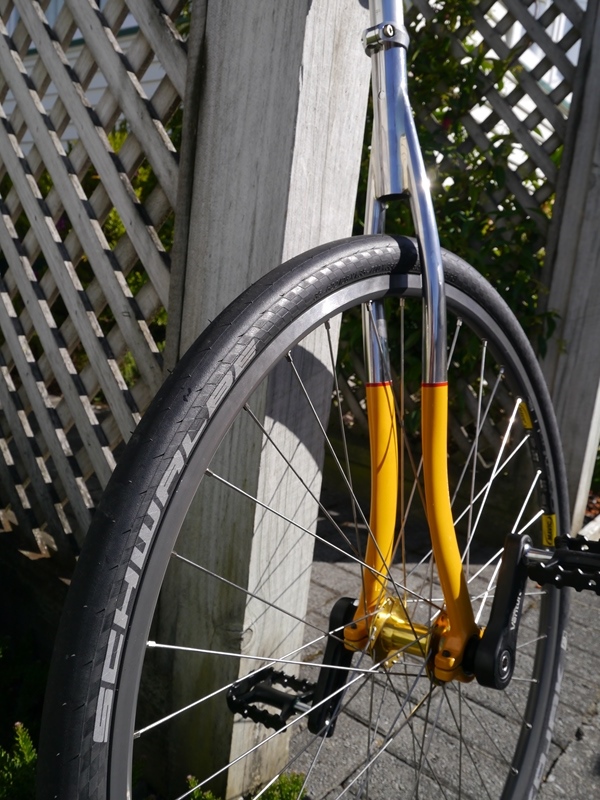

I use the Nimbus Eclipse (92mm) hub laced to a 700c Mavic Open Pro rim, which I find excellent. It’s lighter than the 100mm Nimbus Equinox hub, and still fits in a 100mm frame if there is a bit of flex (I can get it in my 29" Triton).
It’s such a great set up I’m building another one with a slighter wider road rim.
This is the 92mm hub in a custom frame:
