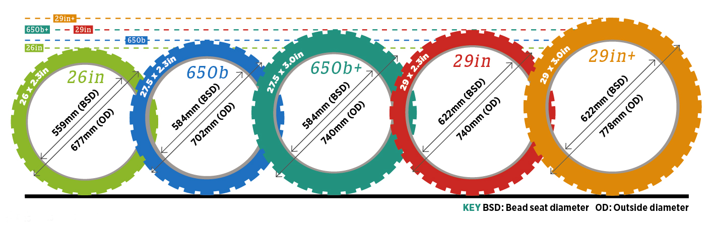

That’s something that has always confused me, rim sizes & how much a tire will change the outer diameter of my wheel. I do like the size of a 29", I had that KH one and I used to ride it to college many years ago & around town on my breaks.
Does anyone have any experience with the Hatchet line of unicycles and the different tire sizes? I see they have a 29 with a more narrow tire, and a 26 with a fat tire, and a 27.5 with something in between, and they all generally appear to have the same outer diameter from just looking at the space between the top of the tire and the frame. I’m wondering how it might compare in diameter to my old KH 29 franken muni.

A 27+ (27" = 650b) tire will have about the same diameter as a standard 29er.
