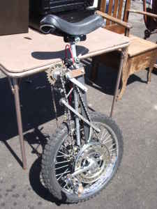

Here’s some pictures of a custom built 10 speed unicycle, and here’s a link to the page I found it on
Pretty neat eh?
haha wow
that thing looks like a deathtrap
i would be scared to ride it…it might just gobble me up
Fascinating. I think I’ve seen pictures of this one before. The guy who posted it (in the link) is a former member of the Pontiac Unicycle Club (they hosted the first USA convention, 1973) and I get the impression the unicycle may be for sale (or was). It looks like it was built with real unicyclists in mind, so it may actually work!
the idea is good however its way to bulky and to much metal.

I don’t think neat is the right word to use here! I can see how it would work, but it’d be better to put the gearinf in a more tidy place. There are already quite a few geared hubs out there and I think that the original Sturmey Archer 3 speed internal geared hub coulb be ‘fixed’ to use on a unicycle. I definitely like the idea of having an easy gear for hills, 1:1 for general use, then a harder gear for some high speeding!
I would love to see some more detailed photos and the design philosophy and a ride report.Someone must have it ?

If one could construct, out of fiberglass or some like material, a cover to “hide and protect” all that metal it would be so much better. I’d hate to have my baggy shorts get caught in some metal bit there at high speed! Ouch!
