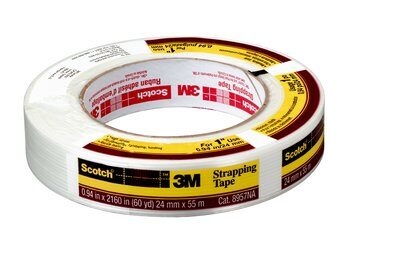

What is strapping tape? Clear-plastic tape used to tape up a cardboard box?
just found this:
and this:
is that what you use? that’s the kind with thread running through the tape. it’s easier to remove.
I use the MTB or road bike rim tape like Velox brand. It takes a little bit more than one roll to do a Coker rim. Bike shops can get the stuff in bulk in a big roll and just cut off the length that they need. So a bike shop would be able to wrap a Coker rim with a single piece of rim tape. Us normal people generally have to use the prepackaged tape that is just a little bit too short to fit all the way around a Coker wheel with one roll.
The strapping tape is the stuff you have pictured. Scotch Strapping Tape that has the threads running lengthwise all along the length of the tape. I used the 2" wide stuff in the second picture you had posted.
You can rip the tape lengthwise and the threads will act as a guide to get a smooth tear all along the length of the tape. I had problems getting long pieces to fit smoothly inside of the Airfoil rim so I had to use short pieces and lots of them.
