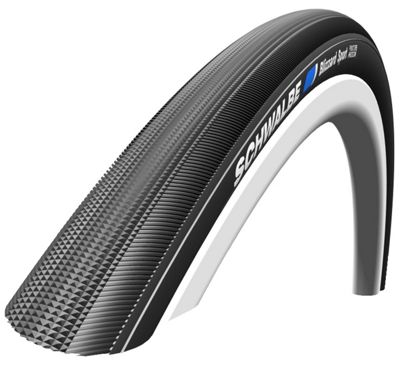

Does anyone has experience with these on a 29"?
Schwalbe Blizzard Sport
http://www.chainreactioncycles.com/Models.aspx?ModelID=36425
Schwalbe Marathon
How does it hold with road and offroad rides?
Schwalbe Marathon
The first one is 700x23, which is too narrow for a plausible 29er; that’s a road bike tire size.
The Marathon is probably fine; a number of people have ridden variants of that tire. It’s still relatively narrow, so it’ll be better for road riding than off road.
