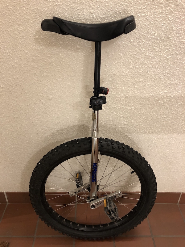

Ok I ordered 100 studs and the tool to put them in (but not from bikeshop.no because they were out). I used Felleskjøpet.no and they were really expensive. I’m going to try studding a Duro Wildlife Leopard 26x3. 100 probably isn’t nearly enough but I couldn’t bring myself to buy more until I have checked them out and see how feasible this is.
For comparison my Kenda Klondike XT 26x2.35 has 368 studs. If this doesn’t work out, so be it. I have been pretty happy with the Kenda Klondike XT 26x2.35 (and still am) but a wider tyre will be better on snow and the spikes should save me on ice.
I briefly considered studding Nimbus Nightrider 36x2.25 so that I can use the big unicycle but the cost of doing so (using this product, sourced in Norway) would make the final tyre more expensive than what I paid for the entire unicycle.
Ok, I now have a 26x3 Duro “Wildlife Leopard” with 76 studs.
I initially tried to be a bit fancy with a pattern but after a test and checking which parts of the tyre were actually in contact with the ground the majority of the time, I took almost all of them out again and went simple.
Now I just have to wait for it to snow again!
P.S. Thanks everyone and especially Erlend, given I went with your suggestion in the end.
