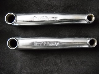

165 mm profile cranks $75.00
165mm profiles, chrome in great shape.
Are these ISIS?
no, profiles are splined. Only fit profile hub.
