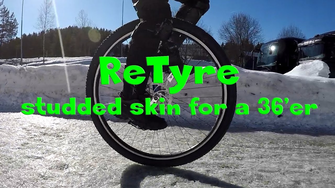

I’ve just visited the reTyre company. It turned out that they were located just 2 minutes from where I live (!). saskatchewanian you were right about the Nightrider beeing too wide, but they had a slightly wider version that might fit even though the thread pattern doesen’t cover the Nightrider entirely. They will try to custom make a reTyre for me just because they think it’s a cool project, so I’m exited to see if it works out. Ideally there should be a bit more studs in the tyre for unicycling, but i think it will be good. They have to make a plastic model of the rim to be able to sew the sidevalls with the zip lock on to the thread. They are going to 3D print this plastic rim themselves, and if this works out, they could be interested in selling this product to other unicyclist. I dont’t what the price will be, but they are only going to charge me for the prototype what a set of reTyre’s normally costs. I left my 36’er with them so they can measure it, but they will not be able to make it until october because they are waiting to get the slightly wider thread from China. I will let you know how this goes.

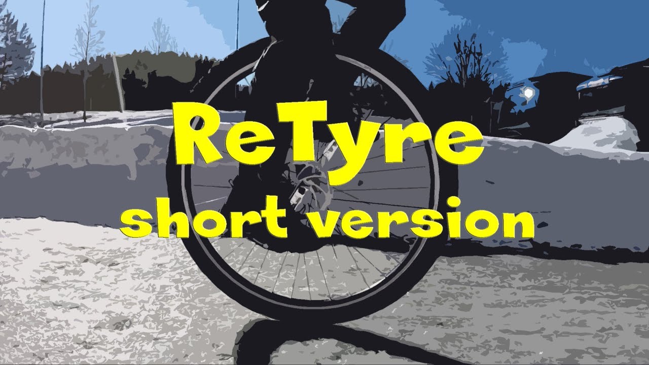

I have now tested the custom made ReTyre skin, and made a video of it. pierrox and bouin-bouin your comments were spot on. The ice is melting fast on the bikepaths her now, but I’m hoping for a lot of 36’er rides next winter.

I think I need to do something about this. ReTyre has a special dobbel sided tape that I will try. It might work. A regular ReTyre has rubber on the side, so it is stiffer. The one I have has a fabric as a sidewall so it streches more, and it’s less rubber to rubber contact.
Yes, it’s a first prototype. They are interested in selling a 36" ReTyre, either a true one or something similar to what I have, but it depends on the market. I wonder how many unicyclists would be interested. The fact that the KH frame doesen’t fit very well is clearly a negative. I used my KH on the first test and it was fine, but after adjusting the ReTyre the studs touched the frame, and I couldn’t get it back to how it was.
If they do decide to sell it, it will probably be a set with a tyre (Nightrider?) and the ReTyre skin together, because the zipper has to be sewed onto the tyre. Being such a niche product it will probably be expensive, but being able to ride a 36’er in the winter is worth a lot.
