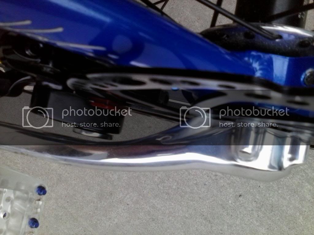

I wanted a disk brake on my KH36, and someone suggested the TRP Spyre mexchanical, so I snagged one and sent it over to my favorite bike shop for installation during my regular maintenance work (the dood’s a total guru and has done all the spoke and lube maintenance on my uni for the last couple of seasons…very happy with the results). Anyway, here are my mechanic’s comments and the image he sent me. Should I maybe pick a different brake?

“Hey John, I just completed the work on your unicycle and wanted to bring one thing to your attention before you came to pick it up. If you check out the attached photo, you’ll notice there’s barely any clearance between the crank and the disc caliper, a little less than 1mm. On an upright bike, more or less regardless of the frame and crank involved, this would be a no-go because there’s not any room left to accommodate flexing of the crank and frame members under heavy pedaling loads. The crank should never be allowed to rub cyclically on anything, even occasionally, due to the risk of rub/scraping on the crank creating a stress riser that can result in failure. On your unicycle I suspect the amount of flex the crank might experience is probably much less because you’re always sitting, and also the “power stroke” part of the crank’s rotation is far away from the part where rub might be an issue. So all told I think the chance of there being a problem with the low clearance on your uni is probably small, but on the other hand it’s an extremely tight clearance and we’re not unicycle experts, so in the end it’s a little too close for comfort for […] and I to warrant that this setup will work without harm to your cranks, brake caliper, or self. If I understand correctly, Kris Holm recommended this brake to you for use on this frame, so I might suggest contacting them to ask if they’ll warrant the setup having seen the attached picture. If they say there’s not any appreciable flex and it should be fine, I would believe that, we just don’t have enough big wheel uni experience ourselves to say for sure.”

What size of rotor it is? Maybe the guy that recommended it to you used a bigger one. Then the caliper should be bit further from the crank.
Hopefully you will be able to adjust the pads using a 3mm hex key. This can give you about 2mm extra play in either direction.
Otherwise it is possible to stand the rotor off from the crank. Either you can use a special adaptor or just 6 washers that will fit on the rotor bolts.

It’s probably a 160. Given how hard it is to find a cable brake narrow enough for a uni I would suggest a larger rotor (with the right adapter) as a better solution than a new caliper.
Or, you could do what I did and grind off metal from the interfering caliper. I remember the first generation of Cooks Brothers MTB cranks that had a groove ground into them by a bike shop to get enough clearance for a front derailleur. That mod was later added at the factory. Maybe that will happen with spirits?

I shimmed mine and everything is fine. Just shim the rotor over from the crank with disk shims or good washers. I have a little less than 1/8" clearance but if you went to a 180 rotor it would help. Its a fantastic brake!
Edit: Just don’t shim the rotor so far over that the rotor bolts rub the bearing housings…

It’s an easy fix, just go to a 180mm rotor, that’ll add lots of space.

BTW: the mechanic used the “shimming” strategy mentioned earlier in this thread.
