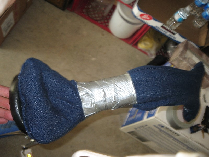

The work is very simple. The bumpers-handle unbolt. The seat cover drawstring unties and the cover comes off. One minute.

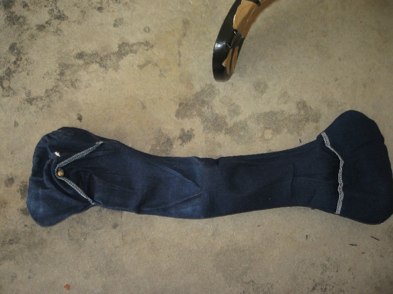

There is 2 obvious places to wrap the duct tape( 4 wraps ), the seatpost and bumper bolts are in the way everywhere else. The inner tube is in a long cloth sleeve(stock) that is taped in an optimized stock position.

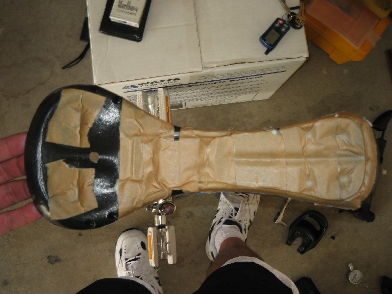

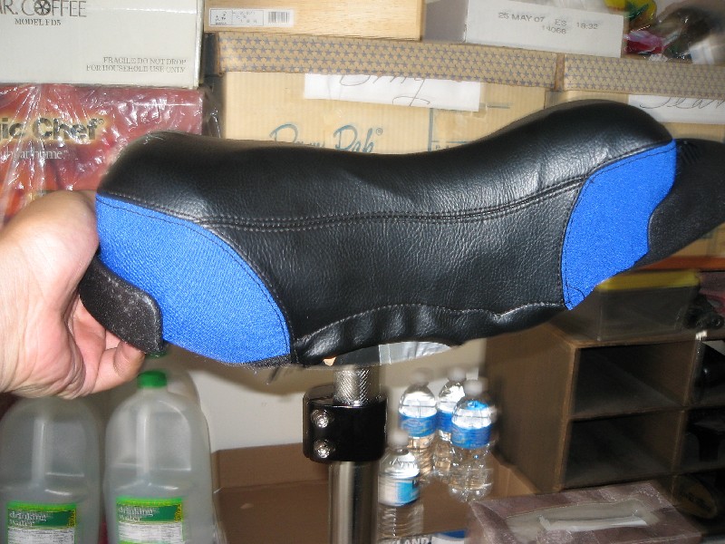

Photos of KH Air
Attached are photos on what KH air looks like. I am very curious about the mold job.
Fill it with air so you know where to tape the first fold part.
Now fold it and tape again.
Deflate and put cover on.

I have the same doubled over sock thing. It all looks the same as your stuff,except my seat cover is all black.
The difference in how I did it, is I taped it in 2 spots, in front of and behind where the seat post bolts on.
