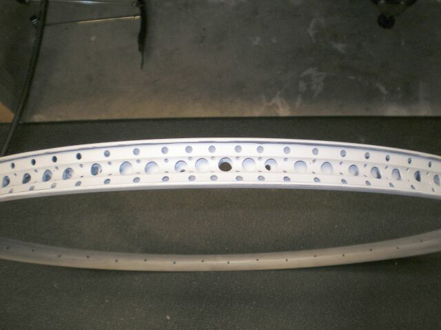

Lots of little holes have been known to take off more weight than a handful of big holes. There are more places on a rim to make small holes.
That said, and having drilled many rims myself, I have yet to explore the reaming out of the outer wall of any rim. I usually limit my metal removal to internal surfaces. Example:
wow, that’s pretty cool to look at.
That’s a really cool rim, unisk8r!
How strong is it?
just over 1000g. If you think a 700c tube in your coker makes a diff, you can feel this lighter rim even more. Drilling a smaller rim will not result in as much weight reduction tho.
Wo is that an airfoil? I presumed that it was some sort of bike rim but your comments amde me look again, how much weight did you save?
I tried to work out how much weight was saved from my my drilled rim on my 07 kh 20 I think I worked out it saved 30g although I may have been wrong, il work it out agin later.
Pre drill design
I am sure that the 07 KH rims are not just drilled. Rather, they were pre made heavy, with the intent to be drilled. There was a lot of thought put into this.
Uniskaters rim appears elegantly done, and makes sense as a racers mod. It is still not what it could be, strengthwise , had this drilling been preplanned by the rim designer.
If you like the look, get a 07 KH rim, rather than drilling one yourself. For general use, drilling a rim will be a lot of work, and it will weaken the rim a lot.:frowning:

Bike trials riders drill thier rims by themselfs all the time. Though yes thought into design might help strength, its not going to matter that much. Just keep in mind the more metal you take away the weaker it will get. I suggest marking the holes first so they dont come out off center. It doesnt have to be unlaced either to drill it.
